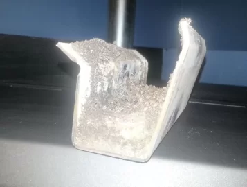

New pellet stove owner, Regency GF55. Don't know if I have too much air or not enough or if I need to adjust the feed trim. After 8-9 hour burn, burnpot is filled with ash and pellets are overflowing out of the burnpot. I am burning Green Supremes and Geneva. Combustion air was set on 4/5 and Feed Trim set at 2/5. Any suggestions would be great!!
Here's a pic of what it looks like after it cools down:
  • [Hearth.com] Burnpot Full of Ash after 8-9 hours??  HELP!!
Not enough air or a dirty stove would be my guess. How many pellets have been run thru since it was completely taken down and cleaned?

Is the stove new or new to you? If it's a brand new stove, I don't think the dirty stove syndrome would be your case. Does your glass get very dirty? Are there unburned pellets in the ash pan? Did you try the dollar bill test to make sure your door gaskets are good? I would try adjusting your pellet feed to the lowest setting and open up the damper some. Or you can go extreme and put your feed on the lowest setting and open your damper completely. You'll see very quickly if the stove is getting too much air. The pellets in your burn pot should start dancing like crazy and literally jump out of the pot and the flames should be very short, probably doesn't get taller then your burn pot. I had similar issues when I first got my stove installed with incomplete burns. I also ended up having to build a wind shield for my vent. The wind can play havoc on a good burn.

OK so here is what it looked like after a 10 hour burn. Feed trim set to 1/5, combustion air trim set to 5/5, heat level 3/5.

From you pic's it appears you are using a high ash burn pot liner.
I have the damper open full (pulled all the way out). I am using the burn pot liner that came with the stove. I don't think it is the high ash one (there are no holes in the bottom, just the front and back). Weird that I would have to buy a different burn pot liner than what came with it (can I drill holes in the one I have?). I guess I could install an outside air kit (was hoping not to put another hole in the house).
