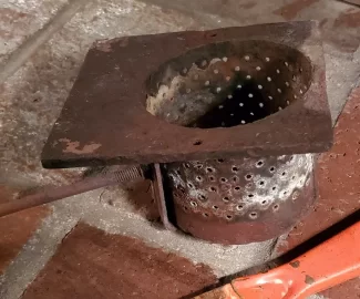

I have a circa early 90's Fabco Nightfire natural draft insert pellet stove. The burnpot is rusting away at the top under the mounting flange. Local welders can't replicate the burnpot draft holes. Any thoughts on how to get a replacement with integrated scraper blade? Any guidance appreciated!

Time to scrap it and move up to a safer negative draft unit. Out of curiosity, post a picture of the burn pot. We have some fabricators on here, maybe they can suggest something....

Just posted 2 pictures. Deterioration primarily around the top of the pot under the flange.

Don't see why a machine shop, weld shop can't make one..

I can but I'd need the old one to get dimensions from. Simple weldement other than than the scraper handle.
