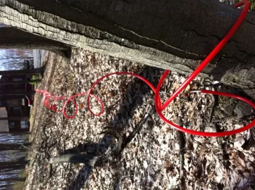

I did non-al pex in may and it sucked. Even left it lauing straight on the driveway for a week. I was up til 3am the night before spray foam guy came. My trench was 24" min at bottom.

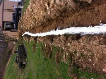

If you have the ability to go that deep I would. But i couldn't. It starts out 16 inches below grade and goes down to 4ft once it enters the house. It wasn't a long run, maybe 40ft from building to building? I put 2 ft wide 2 inch thick sheet foam just below the grade. Normally frost will only go straight down. Also I used thermopex. Damn hard to bend any at all. But i have 15ft of it exposed in my garage, put your hand on it and there is no heat, seems to be insulated well.
I can go down 48" for most of it if I had too. I have the Rehau brand pex which I'm sure is similar to the thermopex. Maybe where I can't go down that far I will lay a sheet of insulation board on top of it. I'll let you guys know how it goes, brother is coming over to help so hopefully it goes smooth.

I got it dug out to around 48" for the most part and the last 10' to the house it's around 24"-30" so I think I should be ok. Lots and lots of sand in my yard made the digging easy with the little excavator I rented.
