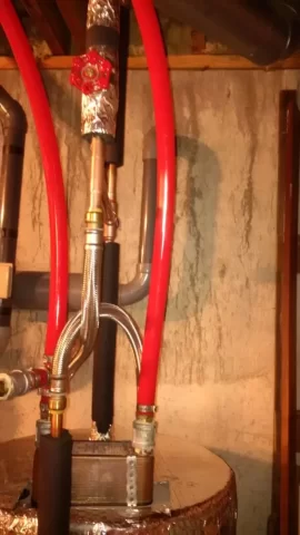

Thanks guys. Troubleshooting has been a bit confusing since I have changed a few settings around here and there. Here's a better timeline of changes.
October, November, December - main circ. pump - Medium - cold water inlet about 75% (this is how it was after dealer finished I noticed, valve is tight, feels hard to turn, he probably thought he was going to break it, so left it there) - Mixing valve on water heater, warmest setting (160F - so is that fully closed, no cold water in?) house heat and DHW both GREAT. (outside temps mild - normal cool values for season)
Beginning of January - main circ. pump - High (thought to do this for cold snap approaching), cold water inlet - this is when I noticed it wasn't open fully, so I opened 100%, Mixing valve on water heater, warmest setting (160F) - house heat GREAT - DHW - NOT great, start of luke warm/low hot water pressure issue. (set like this for about 2-3 weeks - pretty cold to normal cold temps with 1-2 abnormally mild days)
Now (made these changes 1-2 days ago to try and fix issue before discussion of clogged HEX started): main circ. pump - Medium, cold water inlet - 50% (thought here was it was flowing too fast through HEX to heat up - just guessing), Mixing Valve - warmest setting still (160F) - also topped up boiler with water, was down a bit - house heat GREAT - DHW - NOT great, same temp/pressure issue described above in beginning of Jan.
I don't want to focus too much on the hot water pressure, as I know it's directly related to the hot water temp, before when water was VERY hot, in shower, we would turn down (not on full hot tap setting), so this mixed in a bit of cold water into the shower, which kept pressure levels up - water was hot enough to take some cold, and still be hot, keeping pressure up if that makes sense.
I'm going to put the cold water inlet valve to 100% open, as it seems like that's how the system should work...when working properly.
Let me know if you want to see any other pics and I'll upload.

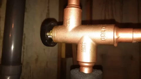

Yes, that is the type of mixer that seems to not last well. For some reason. I have one. It ended up being bypassed not long after I got my system up. Also had one on my old system. I took it right out.
'Cold water inlet' that you adjusted - can you elaborate? Is that a valve on the input to cold water mixing leg only?
Sure sounds like there is not enough hot water going through the mixer, leading to both a temp & pressure drop in DHW.
(You're sure you turned the mixer the right way - right? Fully CCW?)
Again, accurate temp measuring at all the ins & outs of the mixer & HX should tell where the heat is & isn't.
Okay, so I better understand how this mixing valve works, when fully CCW on warmest setting (160F), does that essentially mean the valve is 100% closed not allowing any cold water to be mixed in with the hot water from tank(when working properly)? Yes, it is fully CCW on warmest setting, attached another pic, can zoom in and see set point resting fully on the stop pin in CCW position.
Cold water inlet valve, is just the main valve which controls cold water intake from well to fill up water tank, and now in this case, HEX attached first, then hot water tank. I attached a picture - valve at top. (cold water in for HEX/water tank)

An IR temperature gun is likely easiest to do multiple spots with. But you need to be careful with it to make sure you get accurate readings. They don't measure shiny surfaces good so spray some flat black paint where ever you want to measure. Take many readings in the same place for repeatability, and mix those up with readings at places where you know the temperature. Like at the base of a temp gauge. I think mine does better if I hold it right up to or close to what I'm shooting.
I'm not sure on the internal workings of the mixer. But it has a thermostat, and the guts can be taken out of it for cleaning or replacement. Google the install instructions for it. If you can valve all 3 legs off, I would consider doing that & taking it apart & checking for something in it. Would be easiest first thing to check.
That is, aside from checking all temps first. Still possible the HX picked something up too.
