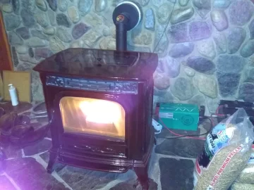

Should be switch to put in Manual Mode. I use Inverter Charger with couple 100ah Batteries (getting 300ah next year). Gets me about 24 hours I hope. Longest so far 10 hours on 1 Battery (100ah). I recommend turning down fan speed to get more hours during power outage. I have Sportsman 1k Generator if longer run time needed. (AIMS 1250 in Picture). Power up here is underground going to house. Your UPS is not worth having except to shut it down.

Our power is underground as well, and is usually pretty reliable except for brief flickers or few minute outages... The UPS serves it's purpose for those scenarios! I'm aiming to build a battery BU system for at least 24hrs to use in conjunction w/ the generator. I'm still in research mode to determine how I want to set everything up, and what V and Ah batteries I want to use for the system. Good tip for turning down the fans! Might just have to build a bigger system! LOL
