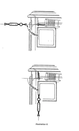

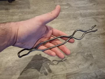

Along with the stove we've gotten a tool that I think I'm supposed to use but can't figure out how to. In a manual I found on this forum it says that this tool should be used to open a 'bypass'. If I'm reading the (very dated) manual correctly this should redirect heat through the stove. This seems like something I'd want to do, because right now it seems like flames (and thus heat, I assume) are at times sucked into our chimney. This means heat is wasted because it's disappearing through our smoke channel! At least, I think it is.
Anyway, my question;
Does anyone have any idea whether:
1. I should be using this tool?
2. If so, how?! I can't find anywhere in the stove where I can use it to, as the manual seems to suggest, open up some sort of bypass.
Attached you'll find a picture of the tool, a page from the manual that shows how to use it and the entire manual. [Hearth.com] Bypass in Efel Harmony [Hearth.com] Bypass in Efel Harmony
While I am not sure how to operate it, if the flamed now go up the chimney, the bypass is already open. You want to close it so the gases don't bypass the path where they can shed the heat into your room.
Having never been near one, it sure looks like you could use a crescent wrench to turn the bypass baffle. If the prior owner was not using, its likely that is jammed in the open position and the catalyst would be plugged solid. The catalyst is going to add resistance to gas flow so unless you can force it to go through the catalyst and reburn the smoke its going to find an easier way to go around it.
My guess it you are going to need to take the stove apart and give it good cleaning to get everything moving again.
