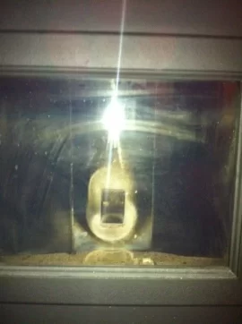

My stove's fire looked weird to me and I decided to turn off the stove. When I say weird, I mean the fire was burning TOO close to the pellet chute (I've never seen it burn like this). Now my stove won't feed pellets.
The "white" part near the chute is where the fire was burning.
What could have caused this and how could I fix it? Thanks for the help in advance!

Total grasping at straws here....but maybe check the holes in the burnpot to make sure none are plugged? Let it cool down and get a flashlight and a piece of coat hanger or something and clean them all. Maybe something is plugged and the air flow is pushing that flame back towards the rear wall?

Completely clear.

Looks like you had a seriously lazy flame and it burned hot where the flame was? But sooty everywhere else?

The ash trap is closed completely. The fire wasn't a lazy burn.

In order to get that much black (the entire firebox looks black), the flame almost had to be lazy?? Or you somehow had entirely to much fuel and there was no air getting under the pellets (ash on bottom)??
