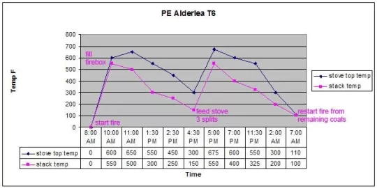

The flue temps and stove top temp don't exactly track together. Initially the flue temp will be higher until the stove warms up and good secondary combustion occurs. At that point (usually the air control is reduced by xx%) the flue temps may decrease while the stove top temp climbs. Here's a chart I did for our stove one day.
If I had charted the temps hourly you would have seen the flue temp higher initially. I plan on doing another chart at hourly increments sometime later when we are burning 24/7, but that will probably be in January.
