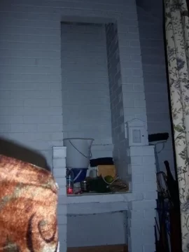

Could anybody please suggest where I can find a wood burning stove that would feet into 17" deep and 20" wide space?
I need it to heat an additional room (300 sq feet) between my house and the garage.
I am attaching a picture of the place I want to put the stove in. There is a separate chimney over it.
Thanks

can you connect in with pipe and use a bigger stove?

Also, is it a good idea in general to put the stove into that tight space? Wouldn't it be bad for the stove or for bricks?
