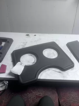

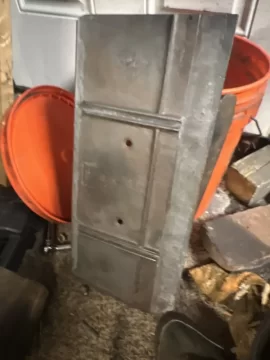

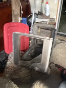

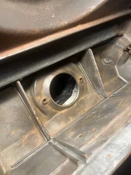

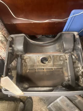

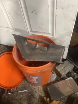

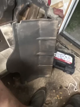

After a long weekend of removing stove polish and painting, I’m baffled on how to fit these 3 pieces. I’ll call em 1 (rectangle flat plate with grooves) then 2 (big plate with half circle) and 3 (side vent)..
what order do they go in?
Do i have to take sides off to fit 2 in?
Do i have the flat triangle supports in the right place?
Are the grooves on 2 to align bricks, or do they face down?
Also was wondering if I should paint the inside?
Any advice is greatly appreciated!

Im going to be honest. You're in for a challenge. But anyone can do it, it's just a matter of how good you are at problem solving problems when you run into them. And well, basic stove knowledge goes a long way too. Just knowing how a stove is supposed to draft internally and work makes a difference.
There is not exploded diagram that I know of for the 500/550/800. So I hope you took lots of pictures when you took it apart. It only goes back together one way.
It uses furnace cement in the channels, and make sure to assemble to stove completely for a “dry fit” with no cement first. That way you will see if you have any fit issues to worry about, and that you have it put back together in the right order. The last thing you want is to take apart pieces that you cemented together, its just a mess and it wont seal properly.
I also hope your baffle is in good shape, baffle alone is almost $600 with shipping. I may be able to get you a slightly better deal if you need it.

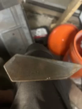

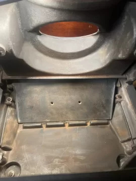

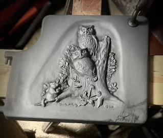

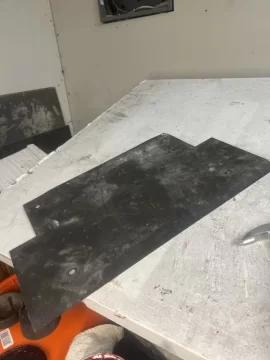

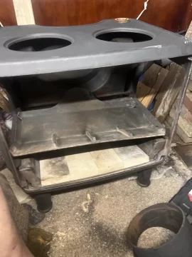

I just realized I have this thin sheet not sure bout it either

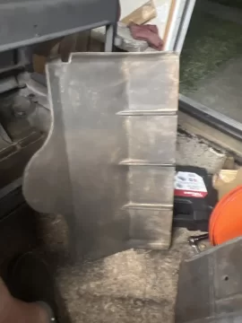

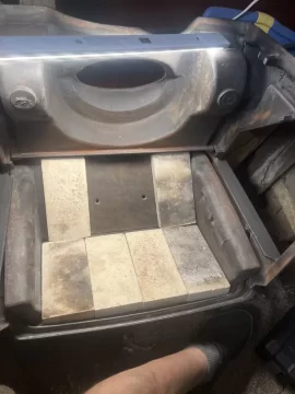

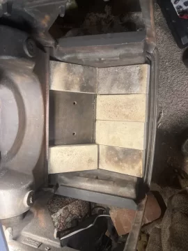

It’s fitting good without this piece (2)
[Hearth.com] Can a Cawley 800 be successfully completely ,rebuilt by a guy with no stove experience and a bad back? [Hearth.com] Can a Cawley 800 be successfully completely ,rebuilt by a guy with no stove experience and a bad back? [Hearth.com] Can a Cawley 800 be successfully completely ,rebuilt by a guy with no stove experience and a bad back?

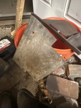

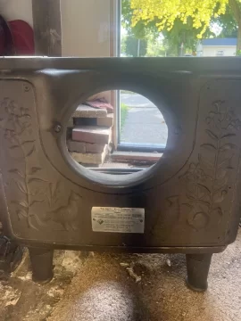

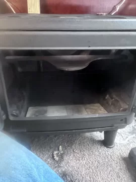

Summary: After a long night, I got it together but have a couple extra pieces. I got this thin sheet and also the biggest piece with a half circle, im stumped on wheee they belong…..

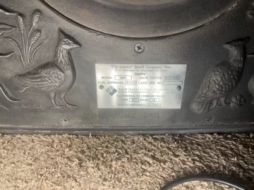

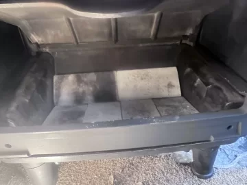

Thanks for the spec sheet! Should I paint the inside or just clean?
If it is going to sit unused for very long painting inside isn't a bad idea. But if it will be used in the next season or 2 I wouldn't bother

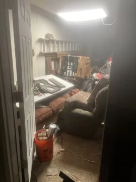

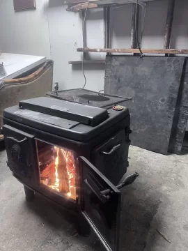

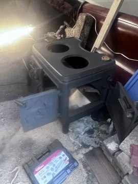

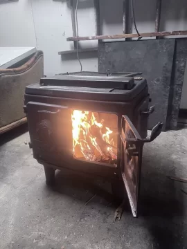

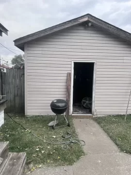

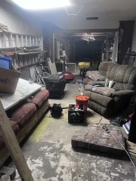

I fired it up last night , no cement or sealant and it worked great.i need to find a couple of the 8” lid covers. I was amazed how much heat you get when you don’t lose anything up a chimney. The 4 doors make it super easy to reach any part of the huge inside. I have a detached single level garage that is 2 car lengths long with a concrete floor, single door on one end and garage door on the opposite end. I can either take the pipe straight up or out the side wall. I found a $100 deal on marketplace for a variety of flu pipes and plan on getting tomorrow. Who would I contact to help me design/build chimney?a? eBay and crabgrass are the only 2 I know of for advertising? I enclosed a bunch of pics

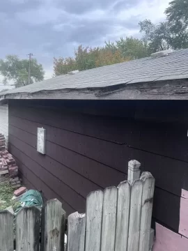

…..but you are taking it apart again to cement it now right?
And are you just burning it in your garage? No stove pipe? Nothing?
Yes im going to take it apart for cement, i put a screen over the exhaust to keep any big ember’s from flying out, and used the front shelf(tray) to cover the lid opening’s. Had both doors open, it smoke initially but then wasn’t bad once it go going’s I cleaned all the ash out and blew it out with a leaf blower then wiped down with a towel. I also pulled the race car outta the garage just in case. Kept an eye on it till completely out with hose within reach
  • IMG_4031.MOV
    15.7 MB
I had a good box fan at each room end pointed outward. Once it caught i closed the stove doors and smoke was eliminated.
Dude has a rippin fire going in a woodstove inside a garage, with NO flue, with a sofa and at least two overstuffed chairs next to it - LMFAO!! As a firefighter, I thank you for a lifetime of job security, and the next generation that I've been honored to help train, thanks you too, I'm sure!
