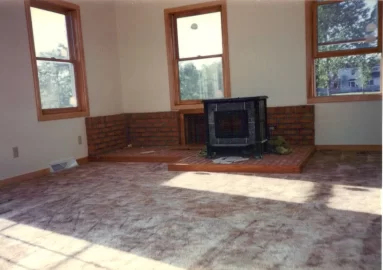

Can anyone identify this stove?
chrisrappl
Apr 21, 2015
7
Raleigh, NC
I built a new home in the early 90s and installed this stove which I bought from a friend who's wife would not let him put it in their new home. I think it was purchased in Holland, NY.
I am now in the process of trying to decide on a stove to install in my present home and the more I read, the more confused I get.
I really liked this stove. If I remember correctly it was soapstone, had a side door for loading, an easy ash removal system and the glass stayed pretty clean.
I'm sure that stove technology has progressed since then, but maybe if I can identify the manufacturer, I can find a current model.
Thanks

It's a Hearthstone. Maybe an H1? I'm Not to up on old models though so I can't say the model for sure.
Hard to be sure from this picture but it looks like a single front door. With that stone pattern I'm going to guess it's a Hearthstone H2. The H1 is larger and has 5 smaller stones across the top front face and double front doors.
Hearthstone is still in business making good soapstone and cast iron stoves. How large a space would the new stove be heating?
It had a single front door which I didn't use very much. I loaded the wood through the side door.
