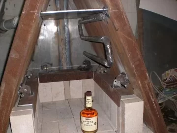

OK: I welded up some 1" pipe and 90's into a secondary air manifold. It has 13 1/4" air outlet holes in the top tube - facing in towards the center of the smoke shelf/baffle.
I have the air inlet ends coming in through the rear wall to give more air heating time in the manifold. A single pass didn't seem like much to me.

Here.
Looks like you have LOTS of firebrick in there!

Yes, that worked. Why is the side firebrick set edgewise instead of flat face forward? Secondary air looks like an interesting design for preheating, but I would think that it should evenly introduce air back to front instead of from one side.

That's the first and last front-wall brick that you're looking at the side of - along the sides the brick is flat behind those retainers.
If you want to See what I mean - let me know and I'll take some pics showing how the side-wall bricks are installed.
Also: that is only one of the two secondary air manifolds - there will be another exactly like it on the other side. I didn't build the second one yet - but I wanted to ask you all about it anyway. <g>
Oh wait - I guess you can't see the air holes - look here:
http://www.flickr.com/photos/57525667@N06/5524292091/
That pic shows the row of holes in the uppermost tube of the secondary air manifold. The holes are towards the center of the stove.

I stopped to look at wood stoves today and found that their secondary air distribution tubes have LOTS of holes in them. The area of the holes appeared to far exceed the cross section area of the manifolds themselves.
Whereas what I did here was to calculate the cross section area of the 1" black pipe's ID and then drilled enough 1/4" diameter holes to equal the pipe's cross section area.
Can I have Too Much secondary air?
Maybe I should use more holes in my air tubes?
What do you all think?
PHM
FWIW, I think that the secondary air is too far from the fire. If you notice the firebox size of most of the stoves in the store, the burn tubes are located directly above the firebrick burn chamber. I'm wondering that, in your stove, too much heat will be lost from the smoke before the secondary air has a chance to do it's thing. As far as hole size, 1/4" sounds a little large to me. I went with something a little smaller when I retrofitted my stove with burn tubes. I also made the last few holes in the run a little larger than the 1st few. The newer stoves with burn tubes have a lot of tubes and have the flow computer designed for the best combustion, so I can't really make any guesses except get superheated air in the right place and it'll do something. Yes, you can have too much secondary air so you have to have a way to regulate it. You should also have a way to shut it off completely in case of a chimney fire.
PHM, I agree with sesmith, that 1/4" air ports are too large. I also agree that the secondary tubes are higher than we would consider normal, but your design isn't normal, so it may work. If you really want to crunch numbers, pull up the spec.s for the Englander NC-30, take the dimensions for the stove and deduct for 1/4" plate thickness. Then reduce that by the bricks. That should give you a baseline, as far as interior capacity. Then look at the secondary air system, the site gives you a nice layout with port diams. Figure that you want your wood about 2" below the burn tubes. Try and carry those dimensions for your interior capacity. But that's a conventional design, your design may behave differentlly. Unless you plan on chucking in about 7CF of wood per load, you may want to make you baffle height adjustable. That will screw with your secondaries, so I really don't know what to tell you. Just my .02. JB
