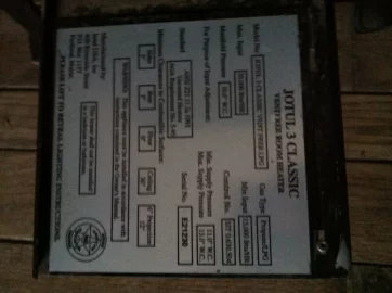

I recently purchased a used Jotul 3 Classic vent free heater. It islet up for LP gas, where can I purchase the kit to change this model to natural gas. See pic of specs. Thanks!

no there is no simple conversion kit for this .The only way to make it natural gas would be to get a new gas valve and O.D.S. pilot assembly.These parts are gonna set you back around 3 to 4 hundred bucks plus install cost.Your better off just getting a small L.P. tank to hook up to that unit and leave it L.P.
