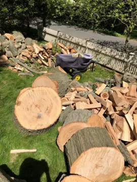

I know you said your wood is dry, but also said Oak... when did you split and stack it?

There’s no reason to modify the stove to get it to burn, you’ve got an ideal set up. Is it smoking out when you are attempting to get the fire going on start up? When you reload it?
I brought two cords of firewood from the old house and it was split exactly two years ago in February.
The new oak firewood was split over the summer but I'm not using this (I misspoke earlier about saying that it's all seasoned). I am planning on burning the newer oak next winter. However, I would think that the two cords that I brought with me should be good since it's been sitting on pallets for 2 years.
