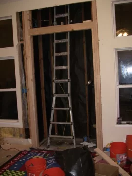

Well it is converting a zero clearance hearth to a freestanding stove alcove. The issue is to get the 2 inch clearance of the class a pipe on the inside wall of the alcove it leaves me a little short on the clearance of the outside wall on the back of the stove to get the 6 inch. I will try to post some pictures later. I am measuring from the back of the stove to the combustable wall per manufactures directions. I will try to post some pictures later.
The smallest offset with double-wall 6" pipe is going to be 5.75". What will be the alcove ceiling height off the floor?
Thanks for the help. When you say offset of 5.75" is that for 60" of stovepipe does that mean I can angle 5.75" over 60" of stove pipe. Do you have a reference for this number of 5.75". I will post a picture of what I am dealing with so far. The alcove ceiling height will be at about 95"
  • [Hearth.com] Can I make a slight angle with the stovepipe.

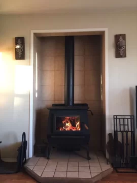

Mine angles back 1 1/2 inches over 5 ft. I've not had any problems yet and you can't really tell because it's in an alcove.
