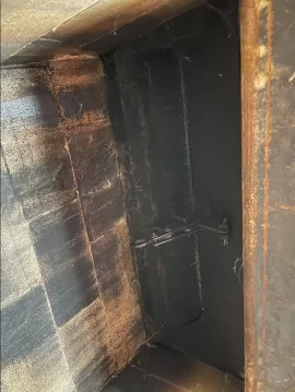

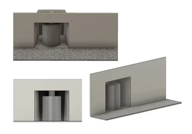

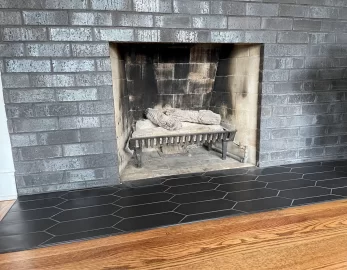

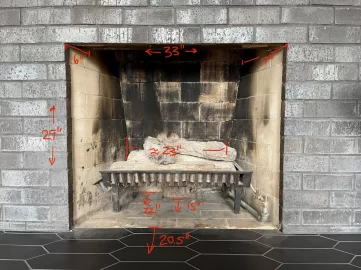

We've always longed to have a modern-looking wood stove in our house. So like many other folks, I am looking to take advantage of the 26% tax credit and have been scouring the EPA database for something that would work in our existing fireplace (removing the gas logs). Not only is our fireplace shallow, it also narrows at the back with only 23" of width. Right now, the only wood stove that I think will work is the Morso 6140B, without the base. By removing the base it would give us about 4" of clearance from the top of the stove to the lintel. (See 3D mockup). The fireplace is real masonry from the '50s, is it reasonable to install the stove on the fire brick without the base? Is this a fool's errand to spend all this money to have a super small stove in an alcove installation where the heat doesn't easily circulate into the room? Any other ideas to make a wood stove work in the existing fireplace? Please be gentle when crushing my dreams of having a wood stove
