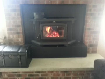

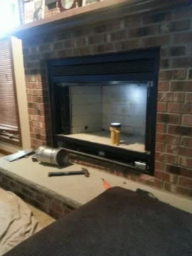

Hi everybody, getting ready to pull out my insert and put a block of plate in, but it never crossed my mind that my insert is in a zc unit, can i still put one in there since its not a standard brick fireplace? is there even room for one?

Hi Grisu, sorry for the confusion, i know i have been throwing alot of stuff out there recently on my plans. So i came to the decision to keep my PE Super insert until my hot water tank dies. Unfortunately my hot water tank flue pipe goes up my chimney, so a tear out would mean to replace my hot water tank with a direct vent or a instant on, i will put a instant on once the tank craps out, then i will tear apart the fireplace and put a alcove in. I just dont want to replace the hot water tank early if not needed. So, i wanted to pull the Super insert out and put a block off plate in and then put insert back in. But, the insert is sitting in a ZC unit, so am i able to put one (block of plate) in there? i believe its all metal in there, is there even enough room up there to put one in? i have not looked up there before the insert was placed in, so im a little unsure if this can be done. I guess what im also trying to say is i dont know how high the block off plate will go, will i be screwing it into the "frame" of the zc unit up in there or???
