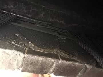

Hello and thanks in advance. I am looking to renovate my wood burning fireplace that we are currently using gas logs in. I would like to remove the brick arch as it protrudes further than the rest of the brick, face the exterior with Durock and add a cast stone mantel and new hearth. This arch does not seem to serve a structural purpose and the top of the firebox is 5 or 6 inches above the bottom of the brick arch. I would love to have the whole firebox entrance open if there is no functional reason not to. I am planning to get a set of high btu ceramic logs. My question is whether that arch is performing any function in terms of airflow or allowing gas waste products to safety escape through the chimney? How do I tell?
I have included a few photos. The last ones are photos of the inside of the firebox above the brick arch.
Thank you!

I realize I should provide some dimensions. The opening is 48 inches wide by 27 inches high at the high point of the arch and 22 inches deep.

Looks like the arch may be a structural part of the fireplace. This may be more of a project than you think. The arch transfers the weight of the masonry above it to the side walls. If there is a steel lintel or some other means of transferring load going from side to side I dont see one. If there isnt one you would need to install one.

As far as the arch being structural, it looks to me like those bricks are stuck on the face of the fireplace. They probably do reflect smoke etc, but I cannot imagine that they are load bearing.

Okay, hard to see from the photos. I see vertical l bricks in the two shots taken from the inside and assumed they were the bottom and backside of the arch bricks.
