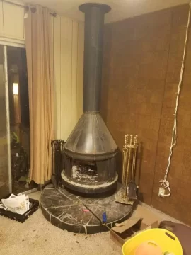

So I have never installed a wood stove and don't know much about the rules/instalation process. I do however know a good amount about construction. Basically I want to replace this fireplace(picture link below) with a wood stove. I'm thinking I'll get a mobile home certified wood stove so I don't have to worry about putting up brick on the wall behind it. I'm looking for some advice and tips on how to do it. I guess the most important thing is will this chimney work with a wood stove? It's a 9" outside diameter. I've read that you can get adapters for the size that comes off of the stove. To make it more complicated I'm looking to buy a used one.
Any and all advice and tips are welcome!
Thank you very much!
