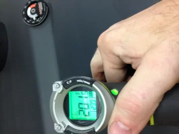

Over 200 on the stove, it is hard to take a photo and hold everything. Easy to hold my hand on a 200 degree surface for at least several seconds. I am not willing to put my hand in a pot of 200 degree water. Temperature is temperature but there is so much more to determining temperature by touch.
According to the ASTM the contact temperature that a human can stand for approximately 5 seconds after which one gets a first degree burn is 111 to 139f depending on the thermal conductivity of the heated surface. Metal is considered highly thermally conductive, ergo either the time or temperature would have to be lower to avoid said burn. My conclusion: If you can hold your hand on metal heated to an honest 200f perhaps you should be applying for membership in the X-Men or questioning the accuracy of your thermometer.
