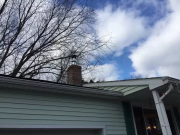

If you get a chance would you please take some pictures of the chimney on the outside?
I want to get some feel for relative heights of the chimney and roof ridges.

FWIW, I ran venting through a masonry chimney as well on my Harman which has a 3" outlet . I adapted to 4" right at the stove and ran 4" all the way through. I have a strong positive draft up the venting. And additionally if your chimney top is below the peak, in which case you need clearances to the pitch of the roof and or clear the peak. If not adhered to you can get bad downdrafts, temporary or constant according to wind direction over the peak. It should all be in your manual.

FWIW, I ran venting through a masonry chimney as well on my Harman which has a 3" outlet . I adapted to 4" right at the stove and ran 4" all the way through. I have a strong positive draft up the venting. And additionally, I think one place where Smokey is headed is that your chimney top is below the peak, in which case you need clearances to the pitch of the roof and or clear the peak. If not adhered to you can get bad downdrafts, temporary or constant according to wind direction over the peak. It should all be in your manual.
