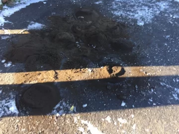

I took the vertical 18' feet out of the chimney and cleaned today and reassembled with the 90 at the bottom and took out the increaser T. Going to install the rest of the 4" pipe to the stove tomorrow. This is how much ash came out of the 18'. I did not think it was that bad. image.jpg
This is just from the 18 vertical part. I did not clean the rest as I replaced it with 4" pipe. It does not look bad though but does have some buildup. Maybe 1/8 inch.
