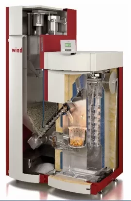

My boiler has a gallon water tank that dumps water on a hopper fire. Hopefully. :)
The water line going into the auger is the blue line and the tank is above.
