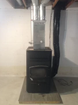

Here is the stove setup from inside. I will post a pic from outside in a few. Also, the stove we have is the 2010 model, not the 2012 so the manuals are slightly different. Not sure if that makes a difference for the backdraft shutter.
The hopper lid does not seal like other units would... I dont know why. If you look at pictures of the stove, you can actually see that the hopper lid sits up a bit. We had about 2 bags in the hopper when it happened.
So how exactly do I prevent this from happening with my new setup? I would like a top fed unit for piece of mind.

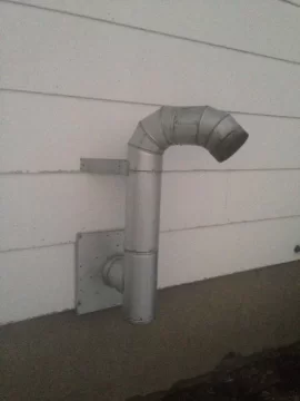

Here is outside. The OAK is at the same level as where the pipe comes out the wall, and is just to the left. Don't have a pic of it.

Good luck. Looking at your install, both inside and out, it looked pretty good to me. Raising your outside exhaust vent another 2 to 4 feet would be OK, but that present setup should work fine. My only worry is how did you clean the horizontal back down to your stove Tee?

Actually IIRC from when I read your manual I would read the termination requirements to be in excess of 3' above the OAK depending on what your code defines certain terms to mean. The US clearances are a bit clearer in certain cases. I'd grill that inspector.
I don't have actual measurements on how much horizontal is in the vent run or if there is any of the venting going downward You have an EVL of at least 28 which is going to cause a lot of ash to be deposited in the vent run especially with the vent termination so close to the OAK which would likely cause a poor burn as evidenced by the soot stain on the termination.
