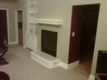

Is it a pre-fabricated fireplace or a masonry fireplace?
It is a prefab fireplace. I attached a picture for clarification

Well, you don't need an insert, you need an entire remodel there. The only option you will have is a high efficiency pre-fab fireplace. Giving the location, you might not have enough room to do much.
The only thing I can think of that doesn't take up alot of room is the Supreme Plus, it puts out lots of heat. That unit you have is only probably 15" deep or so, to get in a wood burner you gonna need alot more, it might be there but the only way to tell is to rip it out! :cheese:(broken link removed to http://www.supremem.com/supreme_plus_zero-clearance_fireplace.php)

Thanks for the update, it's a gas, ZC fireplace. An insert will not go into this gas fireplace. A complete tearout will be required to convert this space to wood.
Before starting, be sure that this is where you want the wood stove or wood fireplace to be located. It should be centrally located in the house to be most effective. If yes, then consider the options. For 24/7 wood burning as a heat source a freestanding stove can do the job well. But if the desire is still to have a fireplace then look at the FPX 36, RSF Opel3, BIS Traditions, for starters, noting the features of each and how well they fit your needs.
