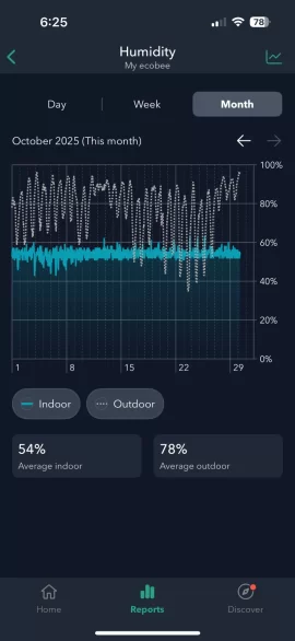

Here is a graph of the RH in my house. AC ran quite a bit the beginning of the month but then it got wet and rainy. I don’t see how an ERV can handle humidity in that shoulder season in a tight house. I don’t have mine set up as a ventilating dehumidifier as my house is leaky 1960s ranch but I can measure CO2 levels in excess of 900 ppm this time of year. If your hvac contractor hasn’t done much with well insulated and sealed homes do your homework. Maybe pay for a manual J and D to be done by someone who has experience with this type of construction after you get a blower door number.
