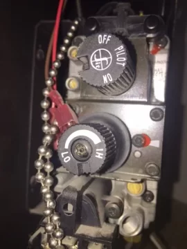

Is it a Tiara I or Tiara II? Can you post a pic of the gas valve?

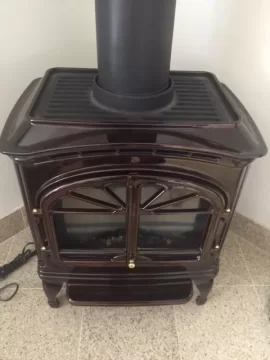

don't know if it is a 1 or 2. Cannot locate the plate with that info.. Here is a photo. Thank You

Are you sure it's a Tiara?
They ALL have an Intermittent Pilot Ignition (IPI)
Yours doesn't. Can you post a pic of the ENTIRE unit?
Is THIS the first page of your manual?
Hmmm...This is puzzling. Is there s power cord attached to the unit?

That is not an IPI valve. I would just light the pilot with a grill lighter...

DAKSY did you see the picture of the valve he posted on post #4? The box may be for a remote receiver. Also I think most manufacturers consider removing and reinstalling the glass as an end user level procedure and it is safer to light the pilot with the glass of anyways.
Yeah, I saw the pic, Millbilly. Looks to me like the remote or the t-stat are not connected to the red & brown leads..

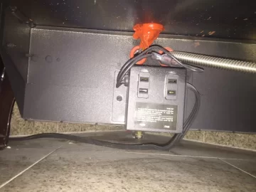

HI is tis what you are looking for. BTW I am quite technical .. Installed my water heater and did all the plumbing in my remolded kitchen as well has electrical work.

Nope. That's the junction box where the blower would be plugged in, if you had one...

Now you light it like any other standing pilot valve.... like DAKSY said it looks like the circuitry to the valve is disconnected so you need to plug them into the connectors as shown in your manual. This is a very easy fix but if this is not making sense you should hire a professional.
