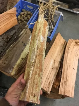

By any chance, did any of those pieces that caused the runaway look like this one? Our evergreen trees can have lots of pitch. When that stuff boils off you can get some hot fires! 20’ is a tall stack. Way over the minimum required by any manufacturer that I’ve read. Thing is, the pollution people want all of this wood gas burned before it leaves the chimney so they’ve forced stove designs that burn it even at the expense of user control. [Hearth.com] Can't control my stove on reloads

By any chance, did any of those pieces that caused the runaway look like this one? Our evergreen trees can have lots of pitch. When that stuff boils off you can get some hot fires! 20’ is a tall stack. Way over the minimum required by any manufacturer that I’ve read. Thing is, the pollution people want all of this wood gas burned before it leaves the chimney so they’ve forced stove designs that burn it even at the expense of user control. View attachment 269076
Nah, i couldnt see much sap in it, nothing like that. If there is one way i would describe this mystery wood is the bark looks like cedar, but the interior looks maple. It is more dense than cedar though, and slower drying.

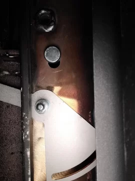

At the very front of the box there's the large hole that the main air controller slides over and to the right of it there's a round hole about 1 inch dia. I assume that's the boost air hole, the other day when the stove was cold and we had the dryer running there was a cool draft coming in from it.
I've stuck a magnet on it covering half the hole up for tonight, seems to have my stack temp down to 600 from 650-700. I'll try it a few days to get some decent data points before completely covering it.

If you can take a shot of that area with a cell phone I'd appreciate it. Don't hesitate to cover it completely as a test for a burn cycle.

Sure can!
I assume the partially magnet covered hole is the boost. There definitely was a draft coming out of it the other day when the dryer was running and the stove was cold.
I can take other pics of it if you'd like. Just might have to wait till it's cooler to get more intimate with it, I'm dripping sweat just getting that one lol
