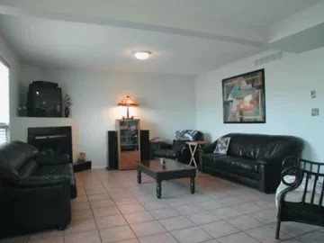

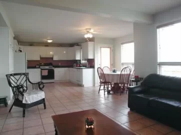

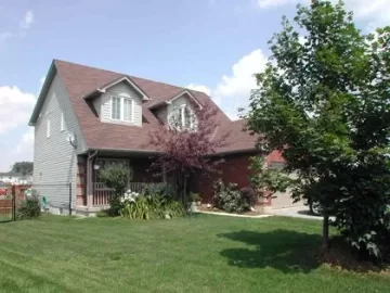

Here are some shots of the house... will be removing the gas fireplace in LR and stove will go there. Chimney will be straight up. I'm guessing the house is 1800sqft, but haven't measured.

room the stove will be in

side of house

Will the stove be in outside wall/corner (under TV) opposite or next to the bathroom? Is it exterior or interior chimney?
yes it will be a corner install were the gas unit and tv currently are. Will be removing the gas unit and building a hearth. Chimney will be inside, and straight up.

Do you know what the R-Value of the place is? From the looks of things, with the wide open floor plan and windows look particularly oversized, and living in Canada my guess is the Summit would be the wiser choice and, I think with steel stoves you can get away with smaller loads. I've seen a picture of a summit burning two small little log splits and having secondary burn action going. There is NO WAY I'm getting secondary burn action going in my soapstone/cast iron 550 lb unit unless I have at least 4 log splits burning. We'll see if that still the case now that I've improved my installation but the PE Summit does appear to be particularly capable of burning much smaller than usual loads for its size and get away with it. Every installation and situation is different though.

I do not know the R- Value... the house is 5 years old so whatever minimum code reqirement was for Southern ON in 2001 I guess??

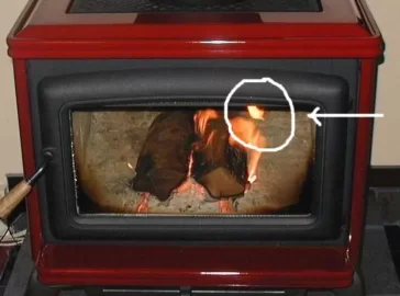

Summit. http://i9.photobucket.com/albums/a97/Roospike/FOURM/P.jpg
Yes , I vote for the Summit as well. You can burn 2 small logs at a time with secondary burn. Tho the dealer says one thing .......... me being an owner of the Summit can tell you differently. Most stove are rated 25% over what would be the normal real live use. My house is 1800 sf and the summit is not too big. Its more stove than i need in the Fall & Spring but when winter comes now its the right size........Thats the way it should be. + with the Summit you get the EBT ( Extended Burn Technology ) feature .
My vote is for the Summit.
  • [Hearth.com] Can't decide between Spectrum or Summit

BTW , Love the new house ..... soon to be "HOME" :-)
