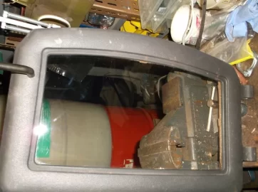

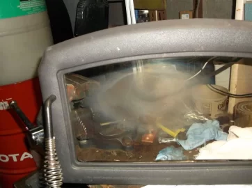

If your glass looks like this:
[Hearth.com] can't get glass door clean
The only thing that will likely clean it, is to polish it with cerium oxide.
I used a angle grinder with a 3" pad. Best to do it outside as it is a bit messy.
You don't have to remove the glass from the door, just cover the gasket with masking tape.
Be patient, as it will probably take 30-45 minutes remove all the haze.
