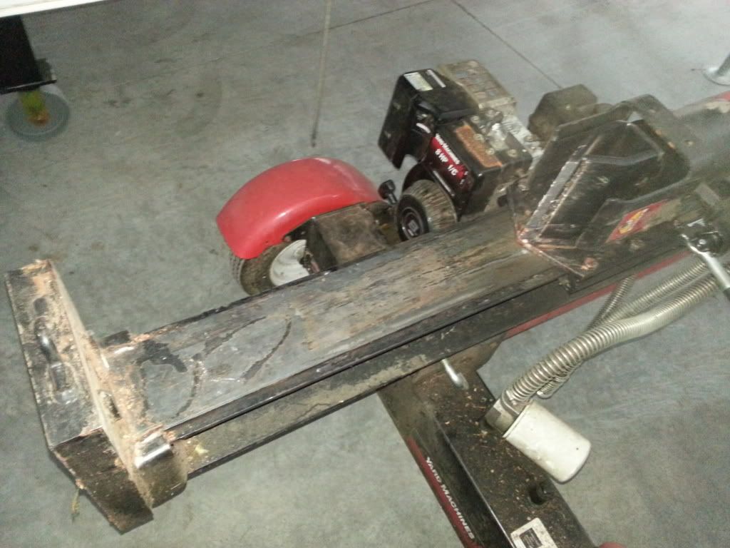

So this is the log spittle I have, an MTD Yard Machines "31 Ton".

It works fine but I would like it to be awesome. I have been thinking about swapping the splitting wedge and foot around. I've looked around and haven't seen any serious mods of splitters.
Maybe I should just sell this and build one from scratch....
I take it you never use it vertically? That would be impossible if you swapped the wedge and the foot.
What are your goals for modding the splitter? Easier use? More speed?
easier use, I would like to use it in the horizontal position. I have always used it in the vertical but it kills my back. I would like a box wedge but I don't know if there is enough power in her to do it.
I would put it up for trade and see what comes along. Most will want the verticle option.
If you want to build a horizontal unit with a log lift (easiest on the back), then perhaps you should weigh the merits of selling it vs. what you already have for parts. (Engine, pump, cylinder, wheels, etc...)
Should you decide to build it, I would consider leaving it as a wedge-on-ram machine, build the chassis and lift, and just transfer the power unit, buy/build a tank, and strap on the existing beam and cylinder. You can always switch the configuration of the beam later and build an outfeed table. 31 ton should be plenty of power to run whatever wedge you want. ;)

To the op, I did what your are considering 2 years ago. HF 30T. No lift. As my beam was sprung and the foot plate bent after 10 years of abuse I rebult it in horizontal only. Ram , pump, tank, motor ( BS) and base frame retained. New beam made from 2, 4x6" -1/4" walled steel tubes. tubes welded together all the way around, 3/8"x8" top plate added on top of the tubes full length. the plate is welded around the circumference as well as plug welded to the tubes. Wedge is fixed on end and welded to the tubes below the plate and then to the plate. Push plate is made out of 1.5" thick material as well as the wedge. Sorry do not have pics on this computer. Somewhere in the archives are a bunch of them. I did consider making the beam the tank, then considered the stress/flex possibilities and nixed that idea. Because the tubes are welded together what I ended up with is a 8" wide 6" tall fully boxed beam with a 1/2" thick center rib, way stronger than any conventional beam. The guides for the push plate are 1.5" x 1/4" angle Iron stitch welded to the sides. If I tear them up easily replaced. Wedge is 8" deep then a spreader behind it, slices through stringy stuff and most knots rather than trying to rip them apart. Note on push plate: needs to be twice as long as high, trust me on this.
