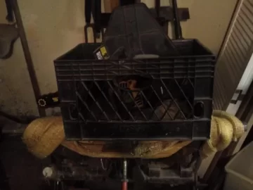

I have a garden tractor with a 3 point. I mounted a plastic milk crate on top of the 3 point and sliced a slit in the lower side to pass the saw blade through. Its not the prettiest attachment but it works. I always thought of mounting a rack on the front, over the hood for carrying items.
  • [Hearth.com] Carrying Saws on a Farm Tractor?
