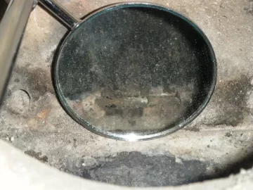

Just curious. In the past I noticed that the slot in the burn pot for the igniter seems like it wasn't opened up all the way during manufacturing.
Here are two photos that I took with a mirror and a flashlight so it's a little hard to see at first.
Photo 1 just the burn pot igniter slot. Notice on the right side the metal is lower than the surrounding area but appears to not have been removed all the way.
Photo 2 the same photo, but this time I circled what I think is the full intended slot opening for the igniter, and the red shows where I think metal wasn't cleaned out. This area in red is lower than the side of the burn pot and looks like I should remove it somehow.

It is hard to see anything in the pics. Something you might be dealing with is the CSS(cold stove startup). The starting sequence is timed. You have 4 minutes, 15 seconds to show proof of fire(you can hear the exhaust fan change speeds), and the green light to come on, telling the stove it has reached 200 degrees, and can start feeding the stove normally. If this does not happen, you will get a nuisance shutdown. With the warmer weather, i have been having the same issues with my Santa Fe. One thing to look for, when you in there with a flashlight and a mirror is to look for any clinker debris, blocking the slit. Try timing it sometime, and see what happens. kap

Not much activity lately so I thought I would report that after replacing my combustion blower (much quieter now) and the cold weather arrival that I'm burning really good now. I didn't try to clear out what I still think is something left from the casting of the pot, but I guess even I could say if it's working leave it alone!
