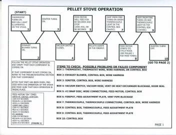

Check to make sure your thermocouple is pushed all the way inside the thermocouple cover. See attached chart for what is suppose to happen.Compliments of Dexterday.
