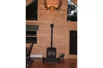

I have a Castile. I went out the back of the stove to a T, went up 6 feet, then out the wall and capped it. Been like that for 3 years without a problem. You don't need to the outside air kit or the top vent kit unless you want it. It's not necessary.

Here is my stove without the top vent. Hard to see as it wasn't a close up.
