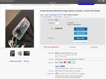

Here’s what I used. There’s no way in the stove programming to idle it down. This seemed to work pretty well.
fyi....I have no affiliation to this product.

I havent had any issues. I suppose if you dialed it down low enough it would detect a “no fire” situation...but no issues. About 30 hrs on level 1.
Got home today a bit after 6 pm, which is about 36 hours after I started the stove. The fire was out, but the room temp was still 70. Outside air was in the mid 20s today. I ordered one of the devices, interested to see how long a bag will burn. Thanks for the link.

What I've seemed to have learned is with "the device" I have to fire the stove up and let it start heating, then engage. Maybe it's common sense, but when I first got it, I'd leave the device on all the time. The stove didn't like being throttled during ignition and would go out even though the stove would start the heating cycle. Of course forgetting I'd shut the draft almost completely, may have had something to do with this issue. This morning it was a couple of degrees below zero outside and the stove had been running about 40 hours at that point. Temp in the room was 62. This is with the stove on manual, set to its lowest setting 1. I haven't made any adjustments to "the device", it's running however it was set when I received it. I'll give it 2 thumbs up.
I guess I never thought about the startup issue. I always had the stove burning, then turned it on. Good info. It will idle it down. So far I haven’t had any issues with mine. Glad things ar3 working out. I think the Serenity is more user intensive than most stoves. After I put the air adjustment rod in, it’s pretty easy to tweak it. For the price point, it’s seems pretty good.

The device certainly won’t get you any more heat. In fact just the opposite. It works by effectively reducing the amount of pellets going to the burn pot. While a bag will last longer....the heat output will be proportionally reduced. But they serve their intended purpose.
If your heat output has dropped, a deep clean would be the first step. Best of luck!
