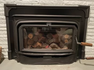

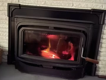

Not sure if this is helpful, but I have the BK Ashford (same insert as the Sirocco). The manufacturer burn times are exaggerated with this unit. I love it. It’s beautiful and burns really clean, but no where near 25 hour burn times for my set up.
These pictures are from different days, but wanted to send you something for reference. One picture is just my fireplace. The other is the BK Ashford packed to the gills with oak and Osage Orange. That load burned like 12 hours before I reloaded it. The other picture is the stove with a pretty full load and the cat fully engaged.
What I have found is that this stove seems to have much longer burn times on partial loads than my larger non cat insert in my other house. Larger non cat puts out more heat on the coldest nights.
Interesting observation. The extended burn times only come when burning low and slow. The glass would probably be mostly black in that case. Osage orange is a primo fuel but as noted, if the demand for heat is strong then the burn time drops down to the range of 3 cu ft non-cat stoves.
To clarify: I get longer burn times in the Ashford from larger loads of wood. The burn times are not much longer than my Osburn 3.1 cf insert non cat. However the smaller loads in the BK cat insert last way longer than smaller loads in the Osburn non cat insert.

That is the cat advantage. It makes sense when smaller loads are in the stove and just a little heat is desired for a low and slow burn to go longer. For us that is heat pump territory, but in areas with very high electrical costs this might not be a preferred option.

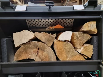

BKVP
View attachment 316798 View attachment 316799 View attachment 316800
Assuming you have about 30lbs of wood in your Ashford, I see about 12-15 pieces making up the load. The burn time is not exaggerated and I would welcome your observations on 30lbs comprised of 3-4 pieces of wood. The load shown has a tremendous amount of surface area exposed to combustion. That is why your experience of shortened burn times is occurring. Do you have access to much larger pieces of wood, say 8"-10" diameter?

I’ve owned several different Blaze Kings. I’ve put the burn times to the test, they are legit, no doubt about it. Obviously it has to be a heavy charge of wood and turned down after the cat is engaged. That type of heating doesn’t work all season long, but is very valuable much of the season in my environment, and many others.
BKVP
Ok. Very helpful feedback. 8”-10” pieces of wood are not my typical wood split size at all. I’ll try to get some bigger splits in my supply. Wood that size takes longer to season than more typical 4-6” splits. I’ll start working on it. Maybe three winters from now I’ll achieve a 20 hour burn.
I scrounge a lot of my wood, so split size isn’t always under my control. Lately I’ve been scrounging split and seasoned firewood, not just logs that need to be processed.

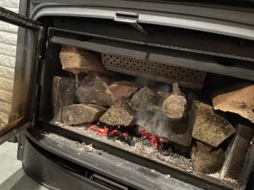

For reference, this is more typical for my full loads NS. Don’t want to highjack this thread, but it’s good to know that my version of a full firebox is not the same as BK’s expectations when testing and recording burn times. This information is helpful to a new buyer in the market.
And to be crystal clear, I love this unit, it’s beautiful and I’m very happy with its performance.

Yes, hardwood needs to be split down to 4-6". I can get away with larger pieces of Doug fir as long as they have a year to season, but not locust. Our Doug fir is split 4-8". That looks like a decent loading. It seems like the cat housing is cutting out usable loading volume. In the Osburn that would be a full width third row. Still, considering how slowly dense locust burns, I would expect decent burn times with it. Is the flue liner very tall on this insert?
