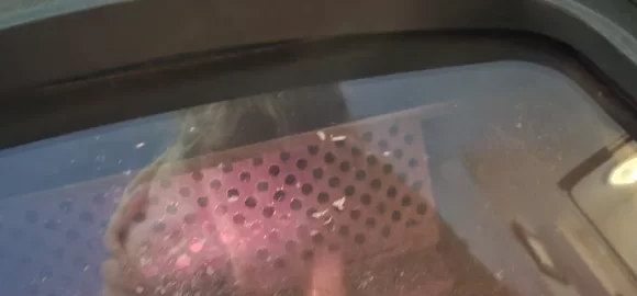

My Ashley20 is 7 years old. It's not putting out the same heat it used to so I am wondering about the cat. It glows, but only in the middle. The sides seem "cool." I burn from October to April with 24/7 burning from December to March. I've used mostly pine and fir since that's what we grow, but this year I landed some birch. When my cord is done I'll be back to fir in the remaining cords. So, it's either the cat, I'm thinking, or maybe the birch is not dry enough. I don't have a moisture measurer. Opinions anyone? See cat photo

It could very well be the cat.
I would order one. And order gasket for a few cat swaps
Then you can run with the new cat. If it runs well,.solved. if it runs the same you can put the old one back.
@Highbeam runs similar heating season and fuel.
Wet wood could be the issue. Cooling off the cat as your baking the moisture out of the stove. Also the entire cat does not need to glow evenly.
When the stove is in the active zone is any smoke visible out of your chimney? How long has the birch been split and stacked out of the weather for?
Here’s some Cat info from the manufacturer;
Regardless, get a new cat. The current one, if still okay, will fail at some point - and given it's age, odds are sooner rather than later. Better have a new one on the shelf ready to go.

I didn’t know Ashley had a cat stove? Have any other pictures of the stove? Anyways I agree with the others that the cat more than likely needs replacing.

Even 28 months of 24/7 burning is more than I get out of a catalyst when I burn low and with PNW species such as doug fir.
Also, that ashford 20 came with the silly steel cat that is even worse for life expectancy and they clog up.
Maddi: Check that cat for cloggage. They clog on the front, the back, and in the middle so it's not always easy to know.
Is it smoking? The cat is well past it's life expectancy in my experience so every day is a bonus. Definitely get a new cat on the shelf because you are on borrowed time. Plus it's just smart to have the next cat ready. These are a wear item.
