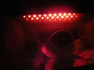

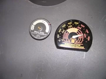

I dont think its the wood to dry. Its never hurt me. How are you referencing the 2000F temp? Is when you have snuffed the fire right out and then it creeps up? @ first turndown there will be alot of extra smoke to feed the cat. Maybe you have turned it down to far to early? The area on the stove top above my cat will reach 750F or so for the 1st hour or 2. Other areas are at 500f or less then it evens out once the excess smoke is consumed.

Thanks North of 60. The 2000º temp is referenced from the probe that is inserted just above the cat. I have engaged the cat when the temp on the probe thermometer was 600º the first burn and 500º on the second burn. The flue temps were the same at that point (read from a magnetic thermometer about 10 inches above the stovetop). My probe thermometer that I purchased has a temperature scale on it so I know exactly what temp it reads as apposed to yours which only seems to have a good and bad zone. Is it possible that 2000º temps are "normal" at the beginning of the burn but without an actual temp scale you would never know exactly what temperature you have? I certainly did not mind the way the stove functioned, I just do not want to replace the $280 converter sooner that I have to. Especially because I involved in the cat learning curve.
A bit of info I didn't post on my initial post. The flue thermometer drops whenever the cat is engaged as I am told it should. It went from 500-600º steadily down to around 300º in the same 15 minute time period that the cat crept up from 500-600º to 2000º

The stove tempurature itself should indicate that all is well, even though the cat is quite hot. Northof60's post #4 shows a photo that is an excellent proof of that.
