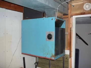

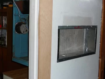

That would be me. I have a chopped down furnace(heat exchange removed and just blower housing remaining) mounted in a wall next to the stove. The aux blower is plumbed directly into my furnace ductwork. The intake of this aux furnace blower is mounted in the wall next to the stove. It pushes the warm air from the stove throughout the house fairly well. It's all in the basement, so the stair case acts as the return duct from upstairs. The better convection I can get off the stove, the warmer the air I push through this system. As soon as I figure out how to post a pic, I will.

I hope this works.
  • [Hearth.com] Cat stove question
Here's another angle.
how well does it work? at the farthest room from the blower does the air coming out of the vent feel warm? and does this blower push air out the other furnace so that air is coming out at the furnace or the return air duct in the house?
The air coming out is warmer than in the room it's in, but not hot by any means. I have to supplement with either electric panel heaters or my furnace for the bedrooms. It's not a perfect system by any means, but the most effective I've found yet. I don't seem to get any air through the furnace or return ducts. When the furnace kicks on it gets interesting. The two air fronts collide in the duct. Basically the furnace only heats the 3 bedrooms at the far end of the house, which is exactly what I'm after anyway.
