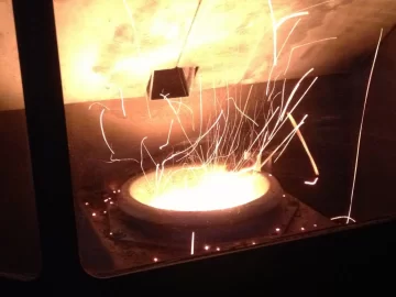

The heat I have now is great but the flame is still off ( or is it ? ) I know you want to see. Picture and as soon as I figure that out I'm on it ! But the flame at times is normal 4 inches above pot but will fall back down inside the pot

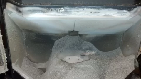

Also have a CB1200 and burned a ton of McFeeters. Liked the heat (if stove was clean) but found them very ashy. The clinkers were hockey pucks in the bottom of the pot unless I pulled the clean-out rod every day. When they were done, I did a FULL cleaning and was amazed at the ash.
Have you checked the chamber behind the firebox? Mine was probably 1/4 full. On the right side, in front of the blower there is a panel w/ 4 screws. Take off and check in the chamber.
This is the ash chamber that leads to the exhaust.

Cleaned it out not much in there but there was a few handfuls . Thanks for the info open to any other ideas !

From the pictures it appears that you have a decent fire. Also appears that there is some fraying of the door gasket (upper right - facing stove). Have you adjusted the feed per manual? Really need to do this whenever you switch pellets.

Hard to tell from the pictures. If that on low? Mine isnt very far above the top of the burnpot on low.
No it's on high !
Try the dollar bill test on the gasket anyway. The flame color looks good but might be a little low. Have you adjusted the feed gate?

Here is what I get at start up on high . I assume you mean feed rate when you say feed gate if so you I have . I can get the flame to come up but can't keep it there all the time . What your saying about the furnance makes sense I guess my Quad has never had to deal with that kinda cold and not for days .[Hearth.com] Cb 1200 ?? [Hearth.com] Cb 1200 ??

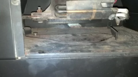

Is your clean out rod EXTREMELY easy to pull?
I had a problem similar and my pot floor had dropped a little, because the the nut had came loose that holds the pot floor to the pot..
Next time the stove is off, open the little area below the ash lip (2 screws) , where the igniter is housed. And check the gap between the pot floor. If you can move the bottom of the pot with your finger and its loose, then the nut and bolt needs tightened.
A little gap here will allow most of your air to come in through that slit and lower the flame height dramatically.

No... The area "Under" the burn pot. My 1st pic shows the gap I am referring to.

I dealt with this yesterday. After some time, the floor loosened the nut a little. I went to snug it up and and the locknut was loosey goosey, I could turn it with my fingers. I replaced the hardware and its a nice fit again. See last post in recent link above. (OP isn't my stove).

No. The area under the ash lip. Near the clean out rod. Take the 2 screws out and check the gap on the bottom of the pot.
Tighten the bolt if its loose

See now I see the before and after picture and it makes sense ! Thank you will be doing that in the am and post my results !
From the pic at startup, looks like your feed is not set properly. After you check the plate at the burn pot start the stove. AFTER the stove has run for about 10-15 min, adjust the feed gate per manual. On startup, the flame in mine is pretty intense and is above the pellet chute. Think you have a two part issue: pot door loose AND feed rate set to low.
