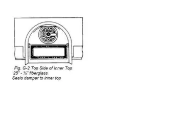

I'm pretty sure the gasket goes all the way around.
Thanx Cert my manual doesn't have that pic.. My stove is older than yours and a bit different but the damper looks similar.. There isn't much of a groove on this stove, is yours that way too?
Ray

Sorry I should have read further and I would have seen your last post. When I installed mine you could barely even tell there was an indent on the sides and the back closest to damper hinge but it was there after I cleaned up the cement. I would expect your gasket to go all the way around the damper also. Yeah our stove are basically the same exact stove except for mine has a larger firebox and my windows are curved instead of square (they even run the same size cat). They say the XL needs an 8" chimney however I run mine on a 6" without a hitch. There are two main reasons for the 8" chimney suggestion....

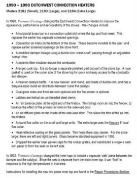

Once again a big thanx!! I don't think my damper is adjustable and it looks like replacing this gasket may be a pain in the butt to install but worth the trip.. I will have to wait until the stove is cold so it will have to wait until next week as I work the next 6 days..
Ray
Yeah I guess you are right about the damper not being adjustable as I checked my service manual and one of the listed upgrades for 1990 was an improved adjustable damper linkage. I attached a list of the differences between our stoves.

I just replaced the damper gasket in my 1995 Dutchwest (small). It is not that bad a job. I removed the damper by removing the two 7/16 screws with tabs on the pivot point., removed the damper rod and picked the whole thing out completely. I found on mine that the gasket groove did go completely around the damper (as shown in the previous pic). I wire brushed and picked the old cement out of the groove with a pointed screw driver and replaced as per Dutchwest gasket package instructions.
