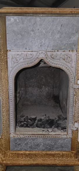

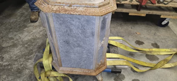

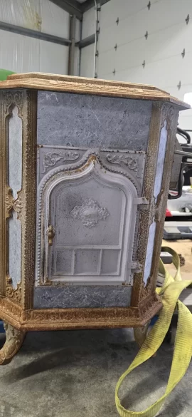

Well, here I go. With a bit of encouragement from Todd, I decided to buy and rebuild a Fireview dated 12/2001.
The stove was in better shape than I expected, and just as heavy as I thought it would be. It's home now waiting for me to start fixin it up. I do see some things that need to be fixed, and some that I am not sure about. So I'm going to post a bunch of pictures here and see what others find, since I don't have one myself to compare it to.

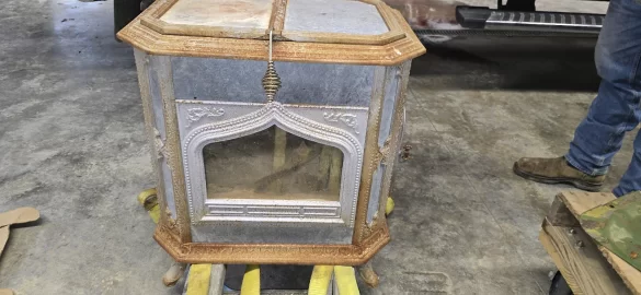

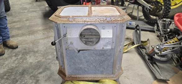

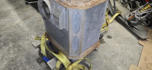

Exterior looks good, mostly surface rust.

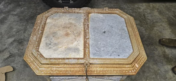

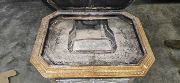

Top of stove, it is not cracked but a vein in the stone. However stained from a cast iron kettle that was kept on top. Guessing that can be cleaned up...?

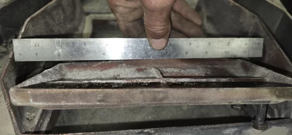

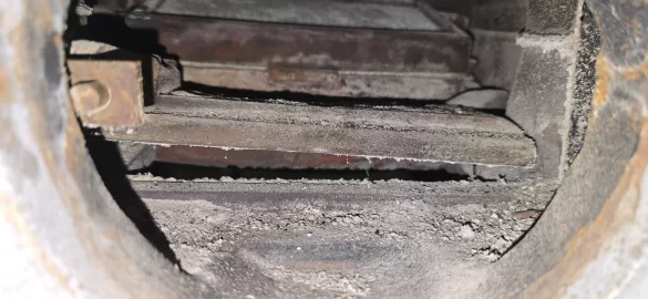

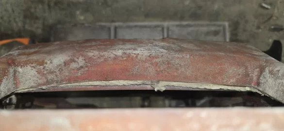

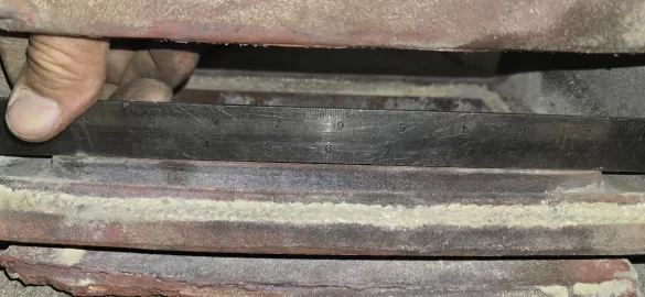

Back of stove I can see the Bypass Cover from the flue, it does not fully close and sits at an angle. Should that fully close?

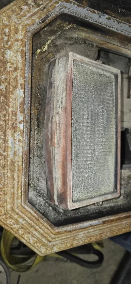

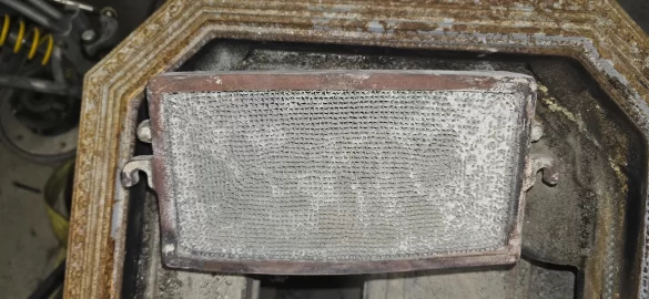

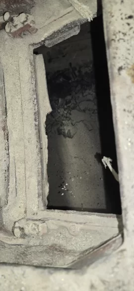

Combustor not seated, looks like there are bolts that are missing. But the combustor looks warped. Can see light through the catalyst.

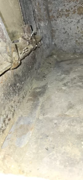

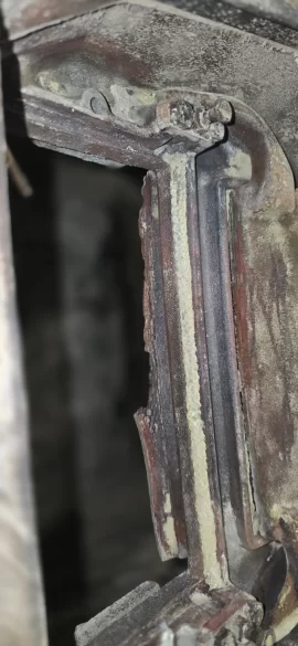

Under the Combustor it looks like the metal has rusted/deteriorated on the edge. I'm thinking that is the combustor pan? Image combustor 2 shows it better.
Fire bricks all look good
Will need a full set of gaskets.

Nice find, looking forward to your rebuild!
Stains come out easily with some fine sandpaper and polish up nicely with some 000 steel wool.
Underneath the cat is a frame that bolts to the air duct baffle. Yours looks like it needs replacing.
You’ll have to take a closer look at the bypass. It could just need an adjustment with the U bolt or the bolts that attach it near the cat. Yes it should fully close and seal on top of a gasket.
I would send pictures to Woodstock and get their advice on what you need. They have all the parts and instructions for your rebuild.
Take your time and ask questions. When you start taking it all apart spray all your nuts and bolts with a good penetrating oil the day before. Tie a rope or strap around it so parts don’t fall off and break.
The four corner tie rods will be a pain if they have the flat heads on top and may be rusted and need replacing. These four rods run from the top to the bottom legs and hold the whole stove together.
Take lots of pictures as you take it apart it will help when you put it all back together.

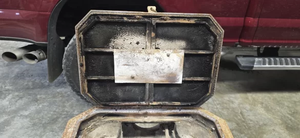

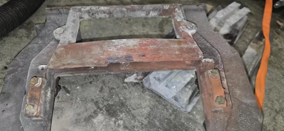

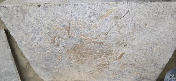

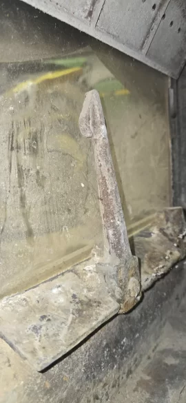

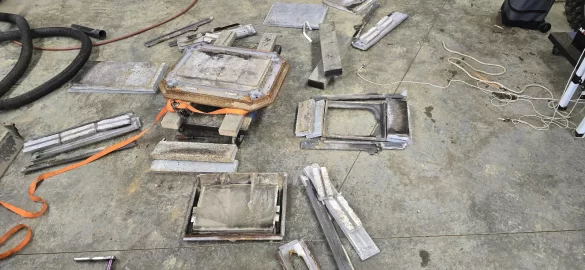

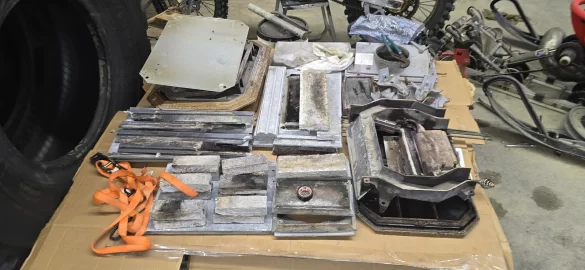

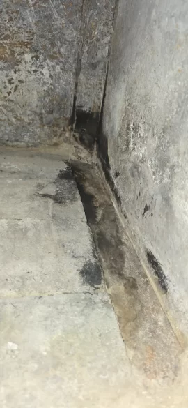

Well it's now in pieces. 99% apart...just a few left waiting on the oil to loosen up the bolts a bit more on the andirons and a few others. It's seems to be in good condition with the exception of a few parts. It was definitely fired hard. The combustor or the iron around the combustor is warped. The bypass door is badly warped, and the bypass frame is also damaged. The back interior soapstone is also cracked through, top to bottom. Handled that with care to keep it from falling apart when I took it out, so I'll be replacing that too. Overall it wasn't hard getting apart. Really the only bolts that I have not take out yet are around the bypass cover. If the oil doesn't help in a few days when I get back to it, I'll apply some heat.

Who's got the popcorn? I'm inspired by rebuilds of old woodstoves!
Reactions: Todd
The bypass cover and bypass frame should be cheap to replace.
Do you have the old cast iron scoop that protects the cat? Woodstock has a new stainless scoop to go with the new stainless cat.
Any warpage or damage to the combustor pan? I think they are over $300!
Reactions: Burnin Since 1991
From what I can tell, the combustor pan looks ok. No signs of warping, if so I'd believe it to be slight. I guess I'll find out when I get the new parts ordered and here.
Yes, got the old cast iron one and it's warped and would need replaced with the new SS model. I send a message off to woodstock yesterday making sure I was looking at the right model. What I saw on the web look so different compared to what I have. They confirmed it's a Fireview 205. An image with my old combustor is attached along with an image of the underside of the complete pan found on their website. I need to go take an image of the underside of my pan as that just doesn't look the same at all.

Yeah that’s the combustor pan upside down along with the stainless scoop on top and the bypass below. Yours will look differ with the cast iron scoop.
Been looking through some of the videos on the maintenance on this stove, and found out why it looked so different to me. There is no cast iron scoop or any scoop on this. Someone must have removed it in the past and didn't put it back on. Ordered some stove paint today, and working on my parts list.
