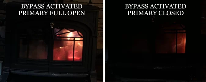

If you light a fire and let it burn with the air intake open all of the way to get the stove top over 500 what happens if you close the air down? Don't touch the bypass damper, just close the air down and observe the flame in the box. You should be able to close the air down to where it just smolders and then open it and the fire should roar back. If you can't shut it down like that and your air control flap is closing you have an air leak past a gasket somewhere.

What happens if you close down the primary air further?
Can you reduce primary air until the stove is running/maintaining acceptable stove top temps without active flame? Relatively common routine on some makes of Cat equipped stoves.

Do the burn test, don't worry about the cat just burn it. Have you cleaned and or inspected your chimney? The reason I ask is if you burn it wide open with no cat it gets flue temps up high if not cut back by closing the air. It is a good way to start a chimney fire if you have any buildup. Do you have a flue temp. thermometer? A good investment is a digital thermometer for the cat and a flue temp thermometer. If you have double wall flue it's best to drill and put a probe in.
The burn test last night showed a significant reduction in flame after the primary intake was fully closed. See before and after image attached.
After loading up the box and achieving a glow with only a minor flame on one side, and the stovetop temp at 450, I went to bed. The bypass was activated and the primary was at about 50%. (I don't yet have a cat thermometer.) I got up 5 hours later to find only embers; not enough to mess with to reignite a new load.
The chimney was cleaned in October with all the stovepipe replaced. (Due to a chimney fire last winter, but that's another story. This time, the stovepipes were installed by a much more reputable installer and the stove has worked much better than before. But the short burn time remains a conundrum.)
Question: if I go to bed with a full load and very little flame, 450 stovetop temp, a nice glow, shouldn't I still be getting more burn time than that? Could the loose glass in the front door cut the burn time in half? (With very little flame, it can't be leaking that much, can it?

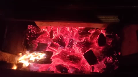

For maximum burn time you should have your primary air completely closed. This is where you prob is super handy.
You should be able to have your fire going and close the damper. With you primary air all the way open you should have a really active fire. You should be able to close your primary air all the way and you should have no fire at all no active flame. If you do you have an issue with you primary air flap or a gasket issue.
How your wood is split also plays a major factor. I split my own wood so I have an advantage when wanting long burn times. For overnight burns I split that wood specifically for packing the box. All of the overnight wood is split is square and rectangle. I pack my box full to the griddle and very little space in-between the splits putting the maximum amount of wood in for the longest burn time and maximum amount of heat.
I can literally load my stove at 7.30/8.00 pm at night and this is what my box looks like a 6am[Hearth.com] Scratching my head raw about my short burn times
