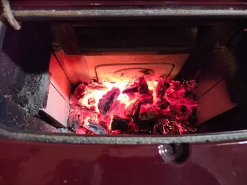

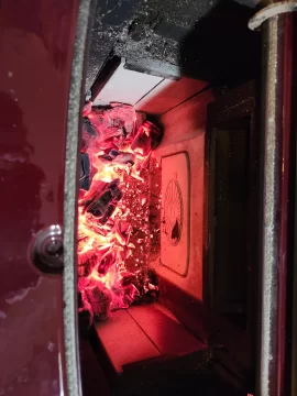

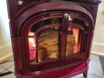

I have had a bunch of free time to browse the forums and have some observations based on my own experience and the experiences here. I have a Dauntless with out the cat. It seems most here run all the VC stoves with the cat installed, whether mandated or not in the flex burns. Most seem to run temperature monitoring well beyond the included factory “probe”. The results every body posts are wildly varying and inconsistent. First observation is the stoves are hard to run. Obviously. But I have some of my own ideas.
The design of these stoves are a secondary burn stove possibly with a catalyst for final clean up. This is unlike, say a blaze king, where there is no secondary air tubes or burning and the entire premise is the catalytic combustor does all the “burning” and the fire intentionally smolders. Somewhat of a big difference. In theory, the majority of the energy release in a VC stove should happen in the so-called refractory engine, not in the catalyst. Or at least during higher burn settings. I believe this is where the problems start. The secondary burn in these stove is temperamental at best. Its not just VC. The lopi Lyden at the time was the same or worse for this.
I have a theory that the incredible temperature spikes on the catalyst people see are because secondary combustion never lights off and the cat has to cash the entire energy check. This is fine at a low burn rate. Not so fine at higher rates when it should have some support. My stove is very easy to tell if it has good secondary combustion or not because the combustion is not silent and the smoke output is tremendous if it doesn’t light. The fix is to re-arrange the wood and fiddle with the damper and air control. Everybody running a catalyst may not notice this except for spiking catalyst temps. This brings us to the combustors.
Vermont Castings seems to run only 2 or 3 refractory engines for all four models. The part number for Intrepid and Dauntless refractory parts are the same part number and the Defiant and Encore share some ceramic pieces. The large fire box for the combustion package seems to not work as well. The Dauntless and the Defiant. No hard science, just an observation. The Defiant crowd seems to kill catalysts the best. It could be that the larger fireboxes are simply too large for the combustion package. I think of all of the stoves the Encore hits its marks the best, but even it has its issues.
For burn characteristics I know I have to follow the manual EXACTLY to get my secondary combustion to light off. The shoveling and piling of the coals are very real. It wont go if I don’t shovel the coals to the back. The wood has to be piled tight against the back of the stove for it to light. If not, no secondary combustion and prodigious smoke. The stove shop I worked with had a Defiant on display. Their Defiant had the seemingly typical sloppy front cover so it was possible to see through the gaps and see when the secondaries lit with a blue-yellow glow. That stove seemed to light MUCH better than the dauntless but their display wood is stupendously dry pine, so that may be a factor.
I guess all if this is to say that maybe the temperature problem is a secondary burn problem. For those interested in experimenting it would be interesting to see if the cat behaved better if great effort was made to ensure secondary combustion actually lit. Maybe it does and I’m just delusional. I know many smart people have many hours trying to make these things work better.
One last note on glass clarity and back puffing. For me, maintaining an air setting that keeps SOME flame present in the firebox is critical. With out that the glass gets truly annihilated and the thing is liable to back puff like crazy. A bit more air calms all of these problems right down.
If you made it this far, hopefully its worth while and can help.

dmccoole, this is sort of what I'm talking about. In theory, on a hot reload the secondary combustion unit is well heated and should be ready to secondary burn nearly immediately after a reload when it gets fuel to burn (smoke). If it did light off there should be zero smoke, catalyst or not. Instead, the cat goes wild because its WAY over worked. A cat that is HOT, not over whelmed, and has a good air supply should not let any appreciable amount of smoke through it. I'm guessing the mid burn temp spike people see is the secondary combustion stalling. With out a cat this is when the fire smolders out as the stack goes cold and everything gets coated in tar. With the cat the stove powers through it, at the expense of very high temps. Again, just a theory. The late stage 800* you speak of sound the most correct and normal. Temps coming out of the fire box will be the hottest with only coals and the cat cleaning up whatever is left.
For somebody that has time, good weather and adventurous, pull that cat out and run a couple of small reloads. See what the smoke level does. Its not a completely fair test as the airflow through the stove is different with and without the catalyst in place. you WILL know if it has secondary burn or not with the catalyst out. Not sure how hot the temp probe would be with direct flame impingement.

The only thing I would add is that I can actually see the orange/blueish catalyst glow when looking in through the glass at the the top of my front access cover when my catalyst is lit off, at least with secondary temperatures above the 1000 range. This is not to be confused with flame impingement, as I've certainly seen that too. And have on many occasion rearranged the firebox to try to reduce that from a burn cycle.

My thoughts would be to try to improve the odds of secondary combustion actually happening. On the smaller dauntless it takes carefully piling the coals and stacking the wood tight against the back wall. It take stacking the wood so some of the flame gets ingested as a sort of pilot light to keep the secondary burn lit. At least until the combustor gets screaming hot. It burns itself completely white after a good run. Secondary combustion is noisy and obvious with the lack of smoke. I wonder if the bigger stoves are the same. A test would be to make sure the mouth of the rear burner is buried in coals at reload time. Maybe this has already been tried. The manual does not offer much on coal management or wood placement for the Defiant. The instructions for the Encore are the same as the smaller Dauntless. The Encore uses at least some of the same part numbers as the Defiant for the combustor. It also has language that the catalyst is not required but recommended. Should anybody pull the catalyst for testing, I would consider removing the temp probe and using small loads. I'm not sure if the temp probe would get direct flame impingement or how much it would appreciate that. I don't have the big stove to test with. When I get a chance I want to build/install a temp probe for my Dauntless, despite not having a cat. I'm curious what the temps are and what they do with secondary burn. More to come on that.

I have seen a difference pushing coals against the secondary inlet. In general the cat heats up and lights off faster, but as always it is not real consistent. I don't always do it because I think it leads to a higher occurrence of over temps.... but I am not sure of that.

I’ll caution anyone testing to be careful about overdoing it when it comes to piling coals against the back wall. Moving them to the back a bit and then leveling works for me. Too many hot coals and fuel pressed against the back wall will trigger very high refractory temps for me, with or without a cat installed.
