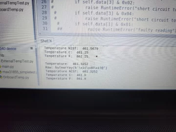

Good Morning.......

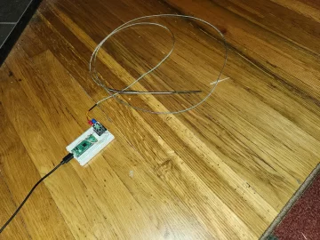

Temperature measuring is real!!
The setup is home brew so take the accuracy for what you think it could be....
The probe is a type K from Auber instruments, the amplifier is a MAX31855 being run by a Raspberry PI pico and interfaced to a regular raspberry pi but any computer running thony could interface with the controller. The end plan is a small standalone thermometer with digital display. I wanted results now.......
The probe is in the flue collar adapter directly above the stove. This spot was chosen because there was already a screw hole and I'm lazy.
So, after a couple of days testing the results of what I see are:
The initial bypass kindling fire I see temps 650 on up. I'm sure with enough wood things could get hot enough to melt.
Bypass closed I'm seeing a minimum temp of 650-700 degrees, with seconday burn.
Early in a burn, a secondary stall leads to temps of 350 or less. I took action to not smoke the hole town out so I don't know how low it would go. This was with plenty of active fire. I did not get images.
Once everything settles in outlet temps run 750-800 degrees.

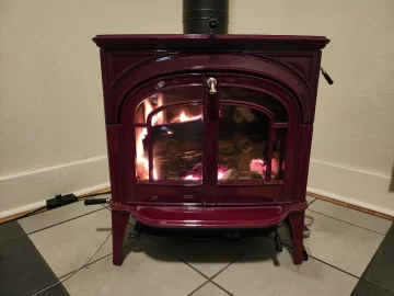

Below are images/samples from today's start. These were all taken after the second reload with a hot ceramic burning and a good amount of coals. Current air temps is around 10*. This is the first time I'm been home to run the stove when its this cold. Most of my burns are in the 30s and 40s or even warmer.
After closing the bypass and the air control the stack temp jumped up to ~1050-1100 degrees. Toasty. Burner noise was obvious. This is normally as closed as I can get the primary without back puffing. After a bit I closed it one more to 6 clicks closed. Again, typically this is a no-go because of back puffing but it settled down and quieted down. The EGTs settled to 850 and as I type this have drifted down to 750. It will coast along there until it runs out of wood. I may give it a click more air in a bit as I am NOT interested in back puffing the house full of smoke, but right now there are still some active flames so its ok for now..... The picks show what its doing.
In this setup I would be surprised to see a catalyst having much work todo and should not be a great deal hotter that what I'm seeing for temps, assuming all the combustion can happen before the catalyst. My stove isn't drilled for the cat probe so my temps will be somewhat lower that right at the throat of the burner where the catalyst would sit. Not sure if any of this proves anything or not or if anybody else even finds it interesting.
There's more to come......
Up next is surface temps. lasers vs surface thermometers vs a thermocouple.
