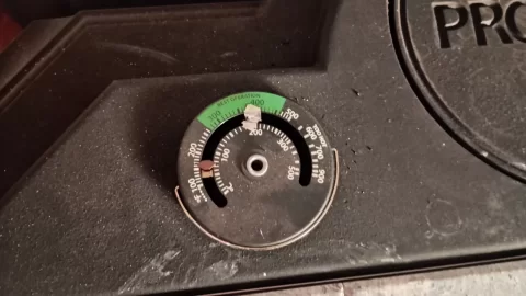

FYI, you can add a small piece of aluminum foil to the slot of the stovetop thermometer that Woodstock provides so that it can indicate peak overnight temperatures. The pointer pushes it around. Crude but it works.
Done this myself. Works pretty good on my Woodstock cat stove. Didn't work so well on the Lopi Answer with the blower (foil blew away, often enough).
