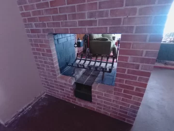

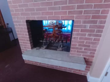

Unfortunately, only a few of those work for us. We have an elevated, double-sided, see-through fireplace. With the exception of a few of the smallest models, all SBI inserts require 84" clearance to the ceiling. We only have 77.5" clearance.
We have a floating concrete hearth elevated 13.25" off the floor that only extends 7.75" inches in front of the firebox. We don't know how much weight it can support, so we really need a flush insert. All but Regency's smallest non-catalytic models would hang off the edge of our hearth. That's true of several other brands too. We were thinking about an IronStrike Striker C160, for example, but its blower compartment would hang off the edge of our hearth. We really don't want the noise of a blower, so we've thought about installing without one, which would shave a few inches off the front of many models. But, never having had an insert, we're not sure how necessary blowers are. Even if we initially install without a blower, we'd want the option of installing one later.

Can you post a picture of the fireplace? It sounds like with this raised hearth that simple ember protection hearth pad extension could work here for some inserts.
Yes, sure can.
My floor is painted concrete, which I'm told is noncombustible according to local codes, so I don't think I even need ember protection (unless I just want to save the paint from char marks). But I don't know how much weight that cantilevered concrete hearth can support, so I wouldn't want an insert extending too far onto it. And it would look pretty goofy to have an insert hanging over the front edge of it, as many would (since it only extends 7.75" inches from the firebox).
If the hearth is done right to code then it is continuouse and reinforced with rebar. There shouldn't be any issues here. The Lopi hybrid inserts are good quality, I just didn't want choices to be narrowed due to misconceptions.
The PE Neo 2.5 looks like it would work.
Also take a look at the Osburn Inpire 2000 for a nice flush unit comparison.
If you like the pass through look you can choose not install the surround. That might influence choices. The liner can be concealed by piece of black 8” stove pipe.
That's an interesting idea. I do like the see-through fireplace. I'll miss it, even though I'll likely burn an insert much more often.
Some models that otherwise would hang off the front edge of my hearth might fit if I left off the surround and was able to install a few inches further back. But not many insert models provide product photography of their sides or back, so it's hard to know what they'd look like without a surround. 🤔
