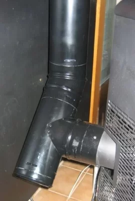

Tilt the tee and use a short length of pipe to a 45º elbow works to center the pipe. No issues doing so. Straight up long runs would require 4 inch piping to keep the EVL in check!
Tilting the tee also makes it easier in the cleanings as there is more room to work the vent brush!

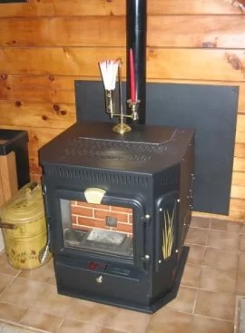

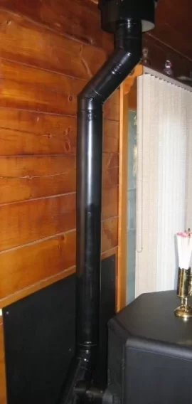

This is exactly what I did in my original stove install to get the pipe centered. Appliance adapter out the back of the stove to a T, put the T at a 45 degree toward the center of the stove and used a 45 to get the pipe straight up.
In my situation, I even had to use 2 more 45's above to get the pipe lined-up with the original wood stove pipe I was going to re-use.
No problems with draft. And Jay was right on with the ease of cleaning too.
