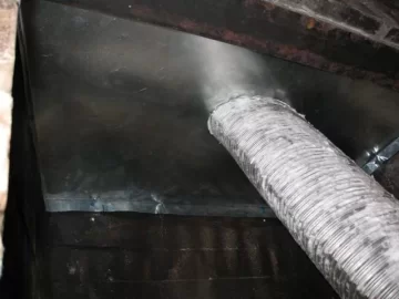

I installed 15 feet of 6†insulated flex pipe:
[Hearth.com] Century CW2500 Fireplace Insert Review
Custom made block off plate insulated with chimney liner insulation. Notice sweet custom flange bends! Hey it works!

Thanks for the kind words on the stove. Nice install by the way. I enjoyed your review but you mentioned there wasnt too many reviews of this unit available. This unit is well rated on Northern Tools web site with many customer reviews.
I also installed my own insert but I used cement board instead for my block off plate. I also used insulation around the insert while leaving about 1" worth of space between the insulation and insert. This way the heat is not spent warming up the fireplace but is kept in and around the insert. I also noticed you did not install a face plate. It might finish the 'look' and its not that expensive. They have them on NT site on special.
